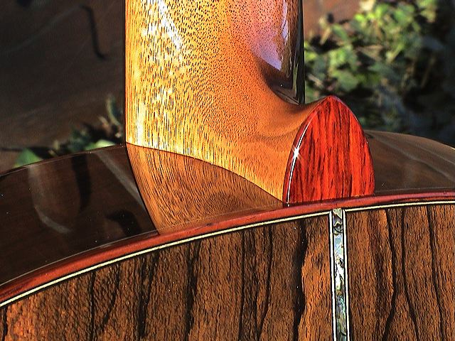

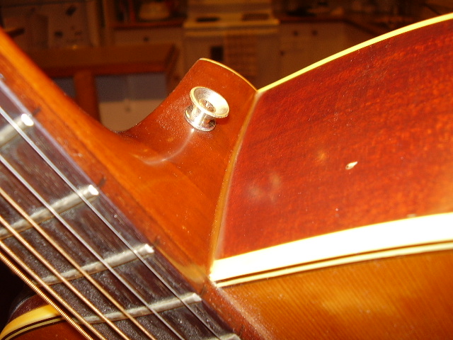

If at some point, you need to do a neck reset or remove the bridge and have finished the guitar after they were installed, you will have a very nasty clump of finish at the corner of the top-bridge and fretboard to top and heal to body to repair. It can be done, but after it's all said and done, you've spent way more time than you would have if you finished prior to installing neck and bridge.
Also, it just looks better. Here's a picture of my Takamine EN-10 which they glued the neck on prior to finishing.
Nice clump of finish there eh?
Now take a look at a nice clean joint like this one on a Truenorth guitar, looks much better me thinks.
